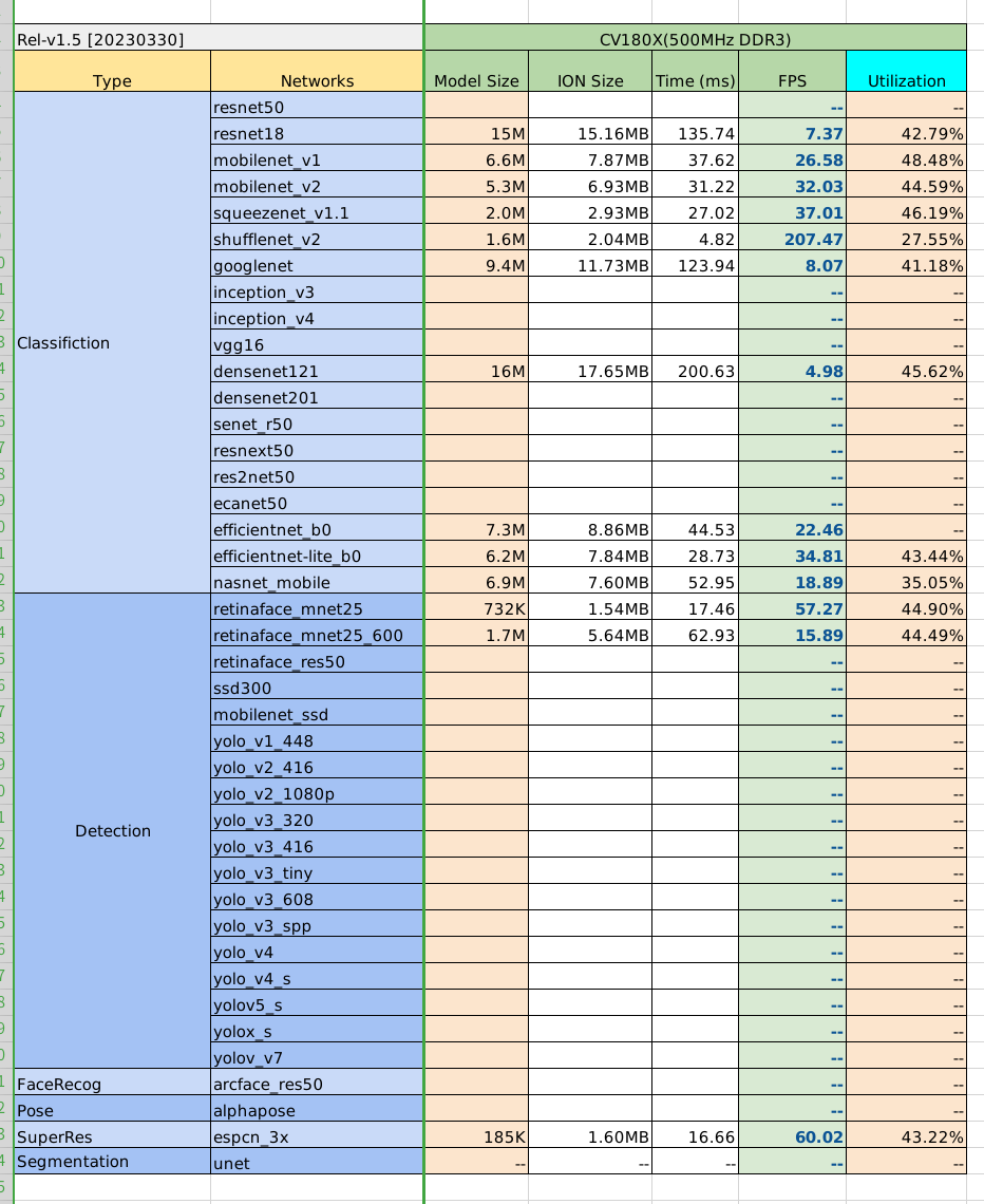

As you could see from The SPEC Of CV1800B, 0.2TOPS computing power@INT8 is a plus to try some ai/ml applications.

Since the RAM is only <64MB on Duo, most of the ai/ml models are not available on this device(too large
). Light-weighting modeling is the only option. Fortunately, Duo is very cheap. Including the models tested in the figure, other models with light-weighting tech also approach to Duo, like Yolov5s, which is not updated in the figure.(Sorry)
