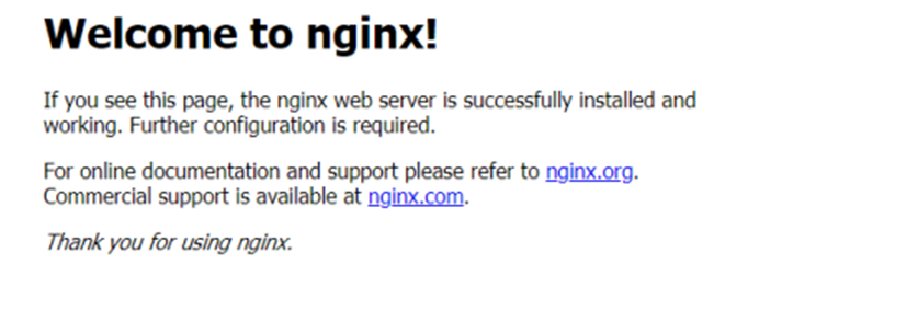

  1. Start Nginx Use the following command to start Nginx:
cd /usr/local/nginx/sbin
sudo ./nginx -c
After successful startup, if you can see the following interface in the browser address bar, it means that Nginx has been successfully started:

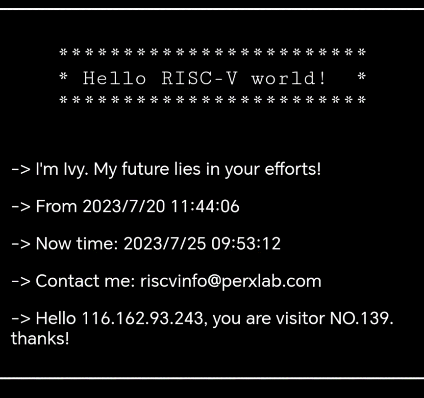

After completing the above steps, you can freely DIY your own web!
Conclusion
We have established the “Hello RISC-V world!” web as a milestone, and we also want to encourage more developers to come to our RISC-V Public Beta Platform and build more interesting and meaningful web servers.
