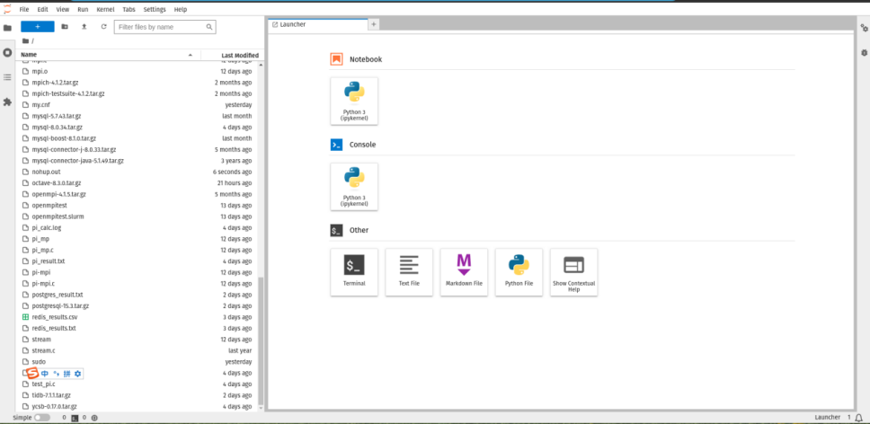

Just access [server address]:8000 with your browser. After accessing it, we found that though we saw JupyerHub running, it only had Python 3 and no Octave option.

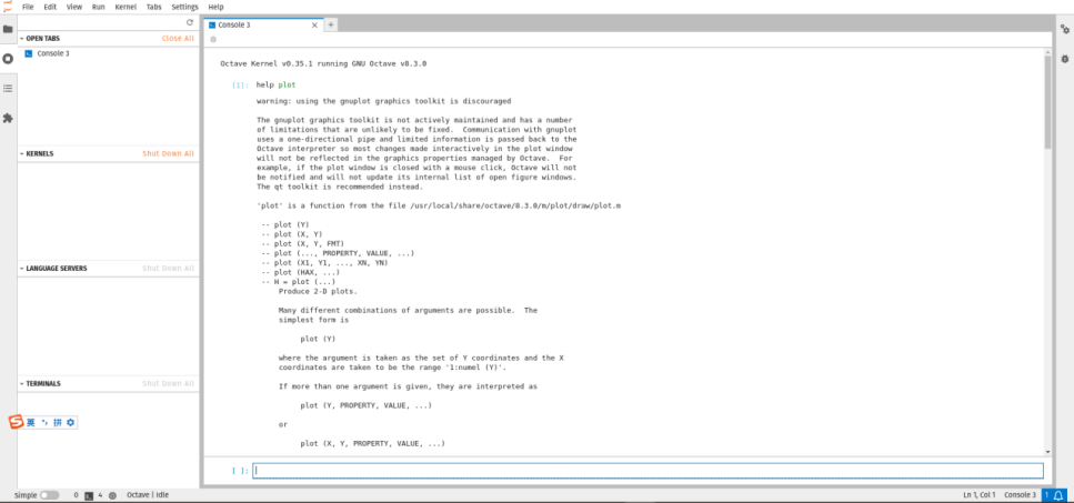

Then open the browser again and visit [server address]:8000 to see the Octave notes.
We choose Octave to create a new note.

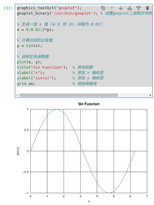

Draw a graph of a sine function:
graphics_toolkit("gnuplot");
gnuplot_binary('/usr/bin/gnuplot'); % Set the path to the gnuplot binary file, the specific path may be different
% Generate a set of x values ​​(from 0 to 2π with intervals of 0.01)
x = 0:0.01:2*pi;
% Calculate the corresponding sine value
y = sin(x);
% Plot the sine function graph
plot(x, y);
title("Sin Function"); % add title
xlabel("x"); % add x-axis label
ylabel("sin(x)"); % add y-axis label
grid on; % add grid lines
Effect:

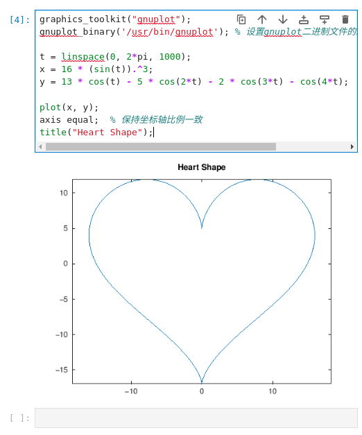

Draw a heart shape:

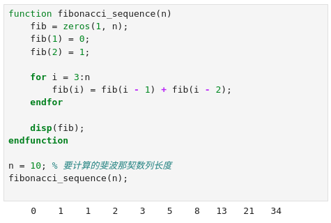

In fact, Octave can not only draw pictures, but can even calculate the Fibonacci sequence.

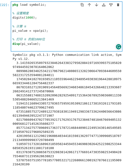

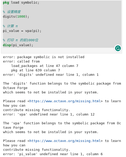

Even calculating pi:
The result indicates that the library is missing. Therefore we need to install the symbolic package.

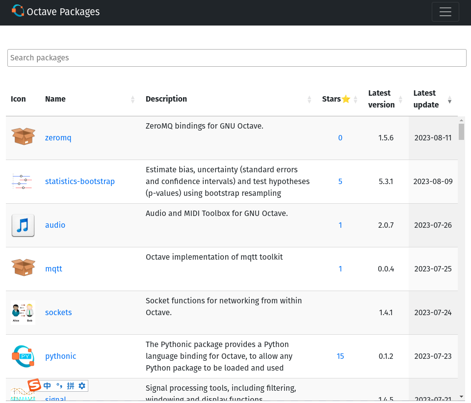

Thanks to Octave’s support for installing expansion packs, we can use some expansion packs to achieve more functions and make Octave more powerful.
After entering Octave Shell, first update the expansion package source, then download and install the symbolic package:
pkg update
pkg install -forge symbolic
Just try running again:
Then test 10, 100, 1000, 10000 and 100000 bits respectively:
10 digits: 1.1531 seconds
100 bits: 1.155 seconds
1000 bits: 1.1567 seconds
10000 bits: 1.2044 seconds
100000 bits: 3.2812 seconds
