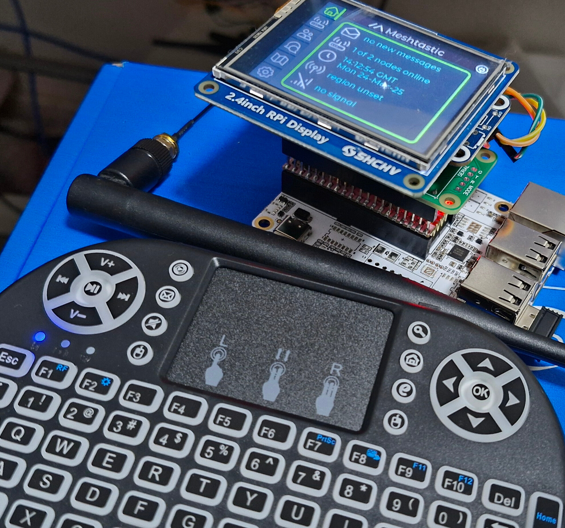

Added breakout to stack SPI Lora and SPI Display to run Meshtastic MUI
